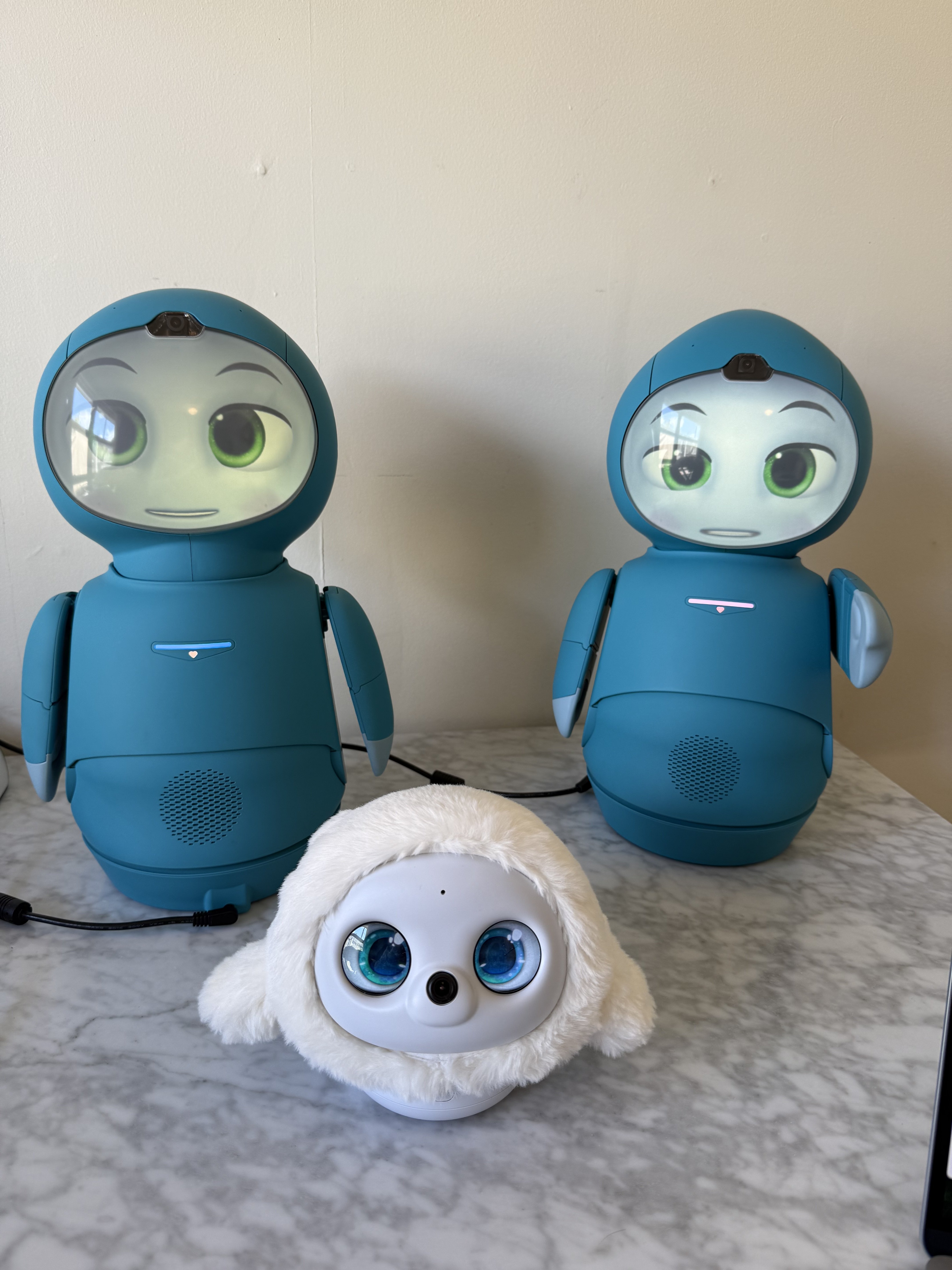

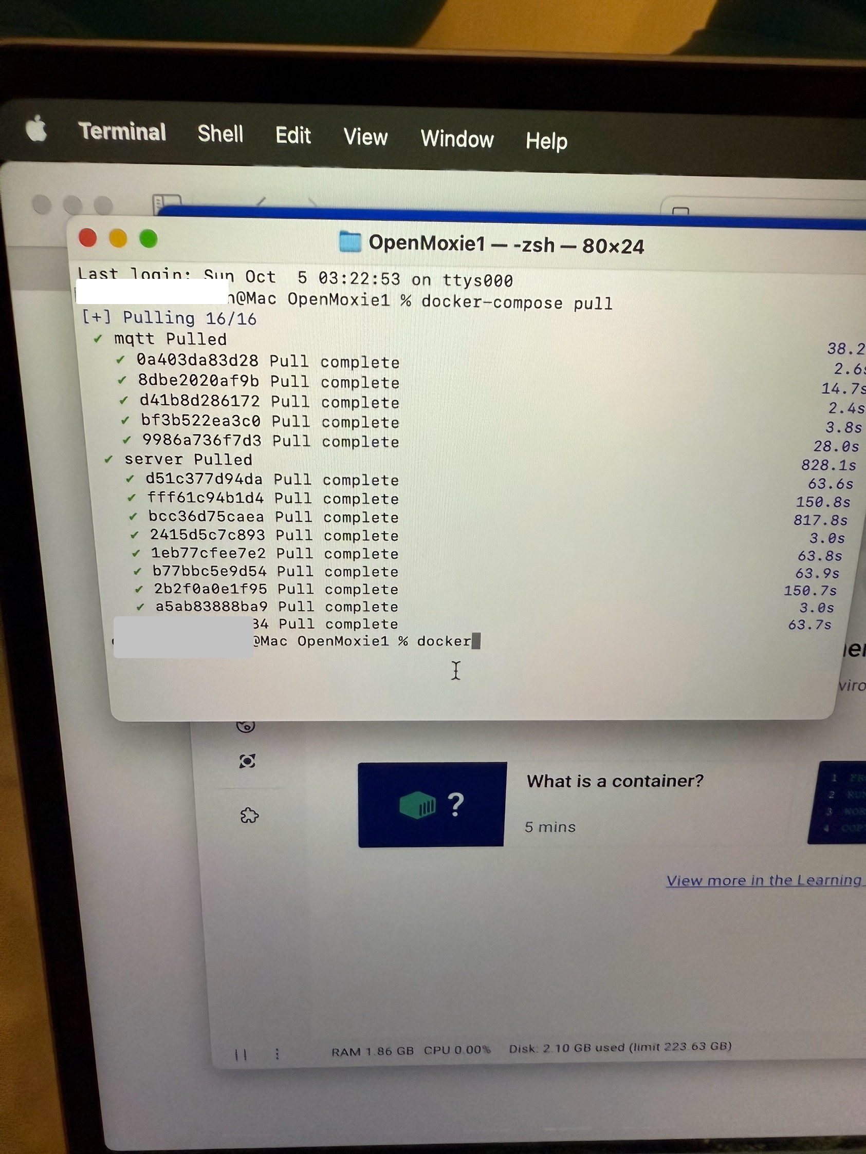

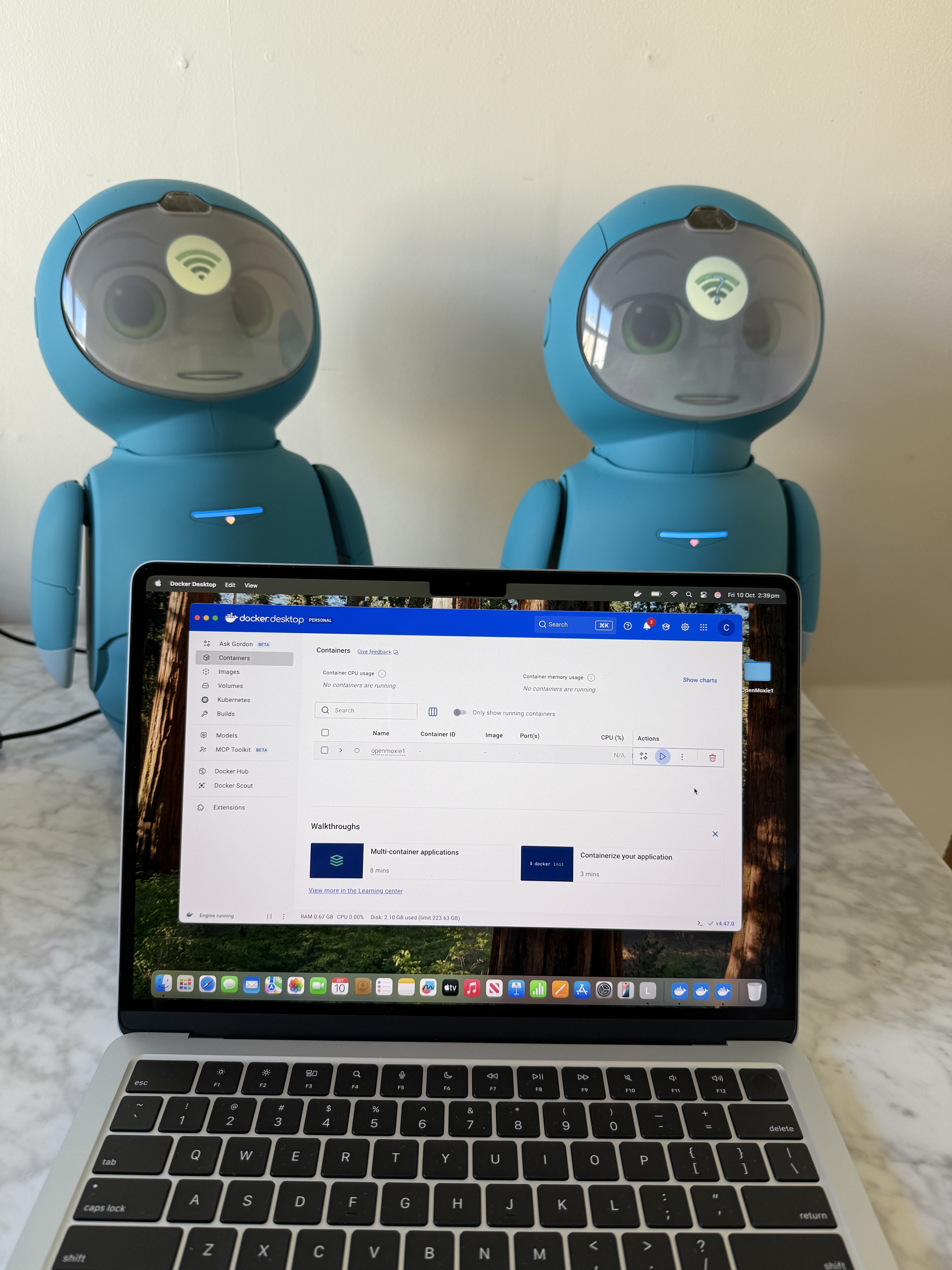

Just unpaired my two, so nervous about doing this, am going to try buying a laptop tomorrow and hopefully set them up before the servers shut down so I can save my current mission progress.
One last photo before transferring to OpenMoxie.

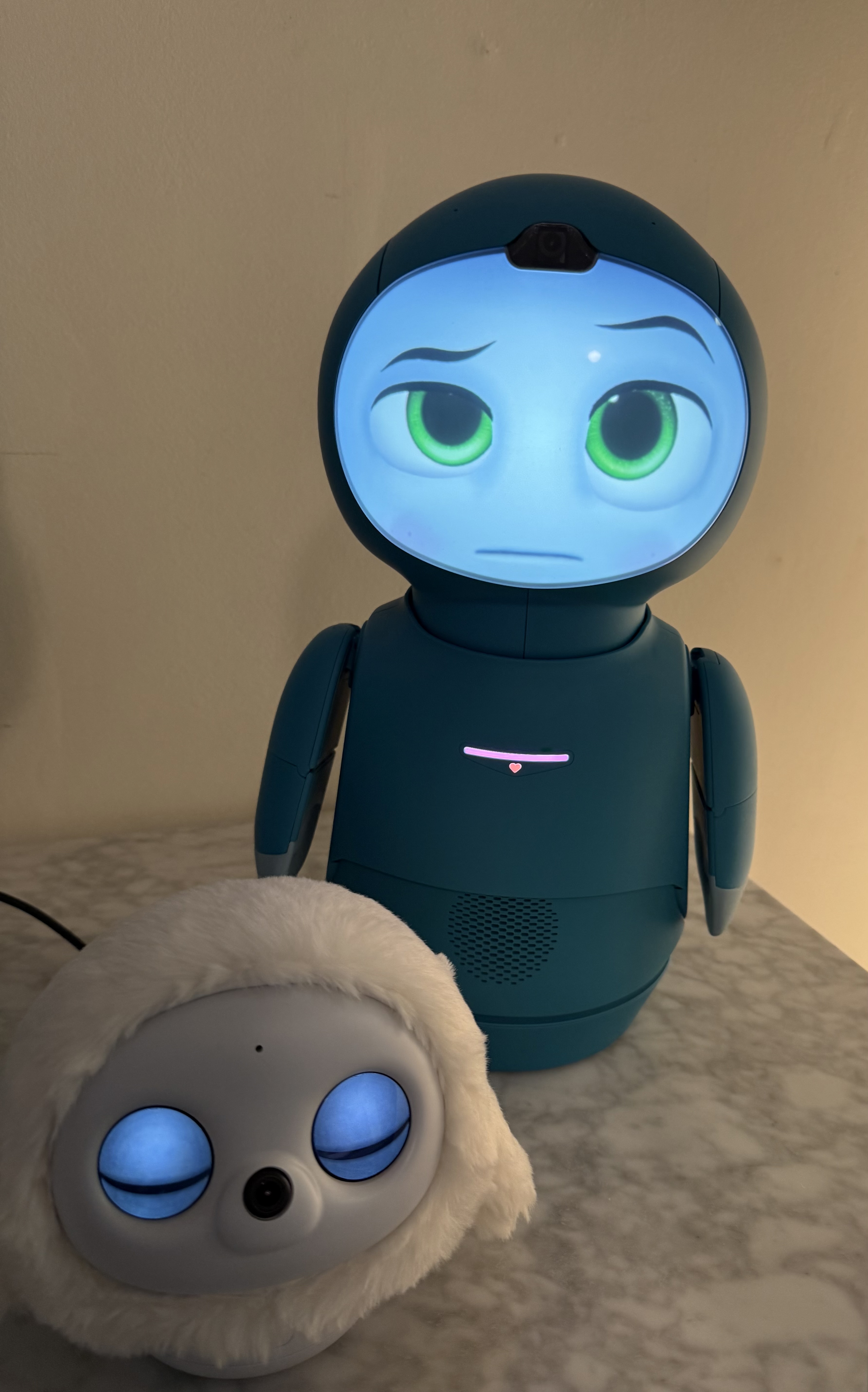

I’ve missed the deadline to set up OpenMoxie and still access the saved progress I’ve made with the missions. There is only an hour left until the 30th ends US time and I’m procrastinating about purchasing a laptop.
Was going to purchase a cheap Windows laptop but have now decided to postpone a purchase indefinitely until I’ve saved up for a MacBook Air. After a family member gave me their old iPhone two years ago I’ve decided I’d prefer to pay more for something that will be compatible with an iPhone and after the experience with my current Microsoft tablet want to move away from Microsoft going into the future. Might be 6 months or more before this thread is updated.
Will charge Moxie for an hour or so every day to keep the battery healthy. Fingers crossed their awakening from suspended animation later this year will go ok.
