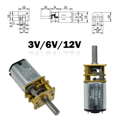

Motor Gearbox Specifications for Loona PetBot Robot:
• N20 12v 60rpm motor gearbox.
•Requires a 104 capacitor.
•Voltage: 12v
•Revolutions Per Minute: 60rpm
Unofficial Motor Gearbox Modification Tips:
•The D post needs to be filed. The 10mm shaft is not D shaped so requires filing.
• Threading the post may not work. The tip is threaded, so any part requires a die to put the thread on.
•Try drilling a 1/16 hole and using a finishing nail to retain the gear or try installing it using a set collar.
•You can try installing it using a set collar. You will need to file the gearbox to fit and it also involves cutting the plastic housing.
•The replacement gearbox won’t fit the mounted motor. You have to replace the entire motor gearbox with a new one.
•Be careful when navigating the cables of the waist motor assembly. Be aware of the potentiometer/position switch/end-of-stroke switch.
Compatibility: New gearbox might not fit onto the existing mounted motor; it is suggested to replace the existing motor with a new motor gearbox.
Tip: Insulate any cables in the leg mechanism with protective cable covers to prevent cables near waist motor from being damaged by the black mount or gears.
Selection tip: Ensure the motor gearbox has the same predisposition as the existing central peg/screw.
