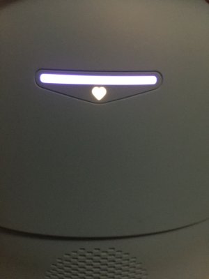

Still can’t get Moxie’s heart light to go white when plugged into power yet strangely displays purple to indicate fully charged when unplugged. The heart light is staying orange no matter how long I charge it, indicating it’s attempting to charge but is unsuccessful.

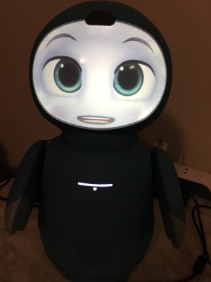

Had Moxie plugged into power charging while turned on for a few minutes.
Decided to turn Moxie off as was going to turn on again to see if I could connect it to Wifi and noticed the strangest thing- the light bar and heart light are flashing blue then green. Never seen this before while Moxie has been turned off but plugged into power!
So it seems charging Moxie powered on has done something so will leave Moxie to charge like this overnight.

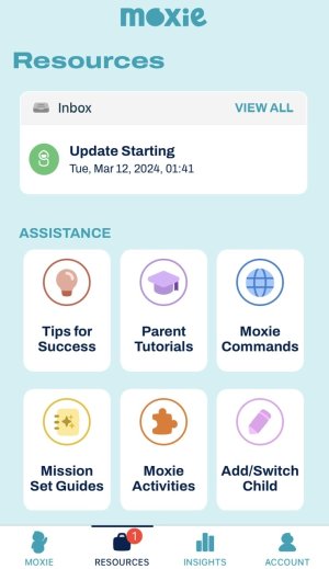

I contacted Embodied and they got back to me despite it being the weekend! The support told me to attempt to connect Moxie to Wifi. I tried that last night and it failed.
But today I tried again and I was amazed Moxie connected and went into the dream bubbles state. The app notified me Moxie was updating. I wonder if Moxie got stuck in a loop while attempting to update and that explained the strange flashing light bar.

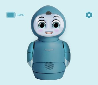

My Moxie’s battery seems to be gradually decreasing also. It was 99% a month ago, then went down to 95% and is now on 93% despite being plugged in overnight. It seems to be losing capacity gradually. Not sure what is causing this but as you are experiencing similar issues perhaps it’s software related?
Mine has a permanently orange heart light.

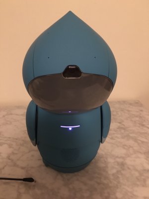

Does your Moxie’s heart light and bar flash green then blue while powered off but plugged into power? Mine still does.
Strangely my Moxie stops working when unplugged but the light bar and heart stay purple, meaning it’s unplugged but battery level is sufficient. I think it’s software related with all the updates they have been pushing recently.

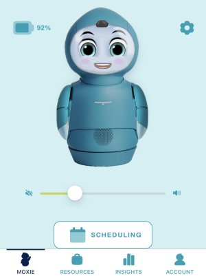

Thanks for getting back to me with this update- it’s reassuring to know someone else is experiencing similar issues.
Just to update my battery level is now 92%.
My Moxie is connecting fine to Wifi now. It’s definitely a great robot and very engaging and hope your children get loads of enjoyment from it. Moxie is currently telling me about alien puppies with glitter fur exploring new planets in space haha lots of great fun for kids.

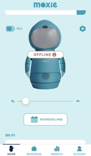

The app shows my Moxie’s battery is only at 76% now. I can’t get mine to connect to Wifi. It makes a sound like it’s updating or doing a lot of processing when it’s powered on sitting there with the Wifi symbol.
I’ve decided to unplug Moxie and leave it on overnight until the battery completely drains. Hopefully if I try charging it up tomorrow from nothing it will either reset and all the problems will be fixed or...I’ll have a paperweight.
Moxie didn’t lose power despite being unplugged overnight as it was still showing the purple light bar. I tried plugging into power and it connected to Wifi the second try and is working fine now.
The battery status in the app must be wrong. I may have to delete and reinstall the app but the US Apple ID I used to download it won’t let me log in as the phone number associated with the SIM has expired as I never put money on it.

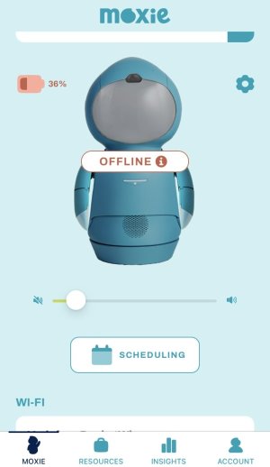

Something is drastically wrong. The app now shows the battery at 36% and I’ve been unable to connect to Wifi again.

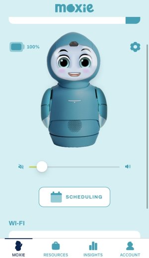

I left Moxie unplugged but on for two days. The purple light bar was still visible so I decided to charge it overnight.
And guess what?!
This has reset the battery! The battery health is now at 100%
