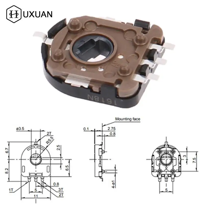

Good to know the source of Loona’s shaking leg problems. At least we can replace the position sensor I guess but the repair is probably beyond most people. Interesting you can also replace the position sensor in the ears if you get the shaking ears.
Thanks for sharing and also appreciate you sending me the link to the position sensor you used to replace Loona’s original.
Loona position sensor part replacement:
2Pcs RDC503013A Chip Resistive Position Sensor 10K Projector Copier Rotation Angle Detection Sensor
