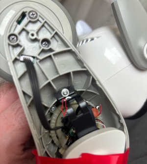

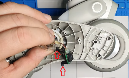

Yes, I experienced the same issue. After replacing the right leg motor, the calibration was off, and the right leg kept staying in the air. I opened it again and noticed that the plastic around the screws holding the sensor above the motor was cracked, causing the sensor to become loose. When I tried to tighten the screws a bit more, the plastic broke completely.
So, I had no choice but to glue the sensor back into its place using a small amount of super glue—just 1–2 drops, enough to hold the sensor. After waiting about 5–10 minutes for it to dry, I checked and saw that the sensor was firmly in place. I reassembled the parts, restarted the robot, and the right leg no longer stayed up. I then ran the calibration through the app, and everything started working perfectly again.
Note: The Loona parts are quite fragile — they break or get damaged very easily. So, you need to handle them very carefully during repairs.
No, this is not the part. I’m sharing a photo of the broken piece.
The round sections that hold the screws cracked and broke, so I had no choice but to glue them to the base.
